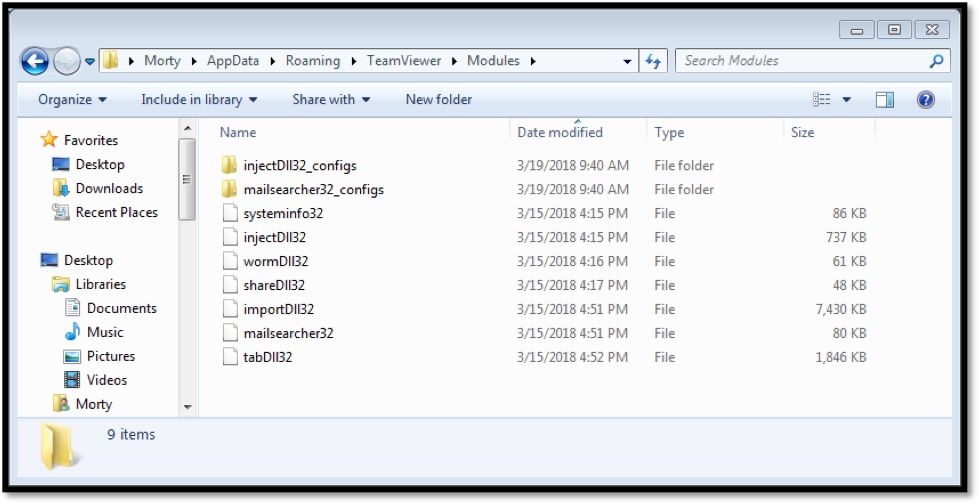

Upon execution, this iteration of TrickBot will install itself into the %APPDATA%\TeamViewer\ directory. If the bot has not been executed from its installation directory, it will restart itself from this directory and continue operation. Once running from its installation directory, TrickBot will write to the usual group_tag and client_id files along with creating a “Modules” folder used to store the encrypted plug and play modules and configuration files for the bot.
Image 1: TrickBot’s plug and play modules used to extend the bots functionality

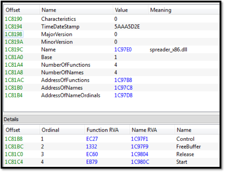

Many of the modules shown above have been previously documented. The systeminfo and injectDll module have been coupled with the bot since its inception. The mailsearcher module was added in December 2016 and the worm module was discovered in late July 2017. The module of interest here is tabDll32 as this module has been previously undocumented. Internally, the module is named spreader_x86.dll and exports four functions similar to the other TrickBot modules.
Image 2a: Peering inside tabDll.dll
Image 2b: Abnormally large .rdata section
The file has an abnormally large rdata section which proves to be quite interesting because it contains two additional files intended to be used by spreader_x86.dll. The spreader module contains an additional executable SsExecutor_x86.exe and an additional module screenLocker_x86.dll. Each module will be described in more detail in its respective section below.

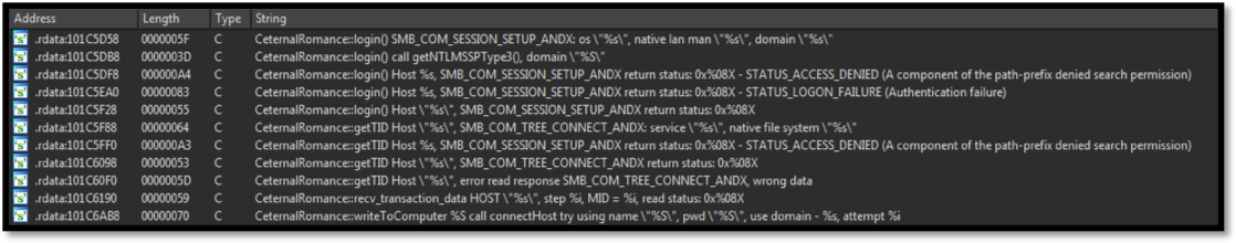

This gives us a preview of how the TrickBot developers structure new modules that are currently under development. When digging deeper into the module, it becomes evident that this module is used to spread laterally through an infected network making use of MS17-010.
Image 4: String references to EternalRomance exploit used for lateral movement

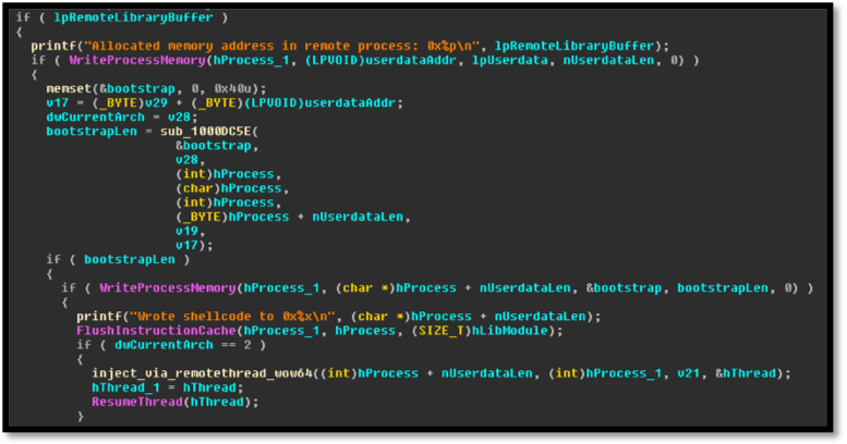

This module appears to make use of lateral movement in an attempt to set up the embedded executable as a service on the exploited system. Additionally, the TrickBot authors appear to be still developing this module as parts of the modules reflective dll injection mechanism are stolen from GitHub.
Image 5: Copied code from ImprovedReflectiveDLLInjection
Image 6: Printf statements from the copied project on GitHub

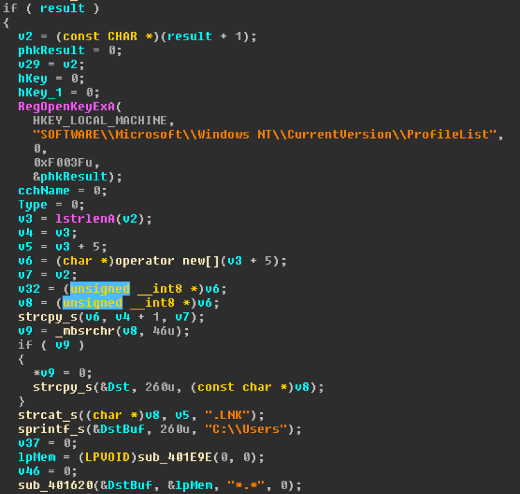

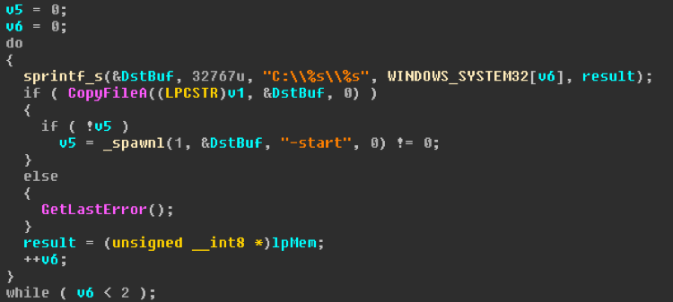

When run, this executable will iterate over the use profiles in registry and goes to each profile to add a link to the copied binary to the start up path. This occurs after lateral movement takes place.
Image 8: Iterate over user profiles and create
Image 9: Execution of the copied binary

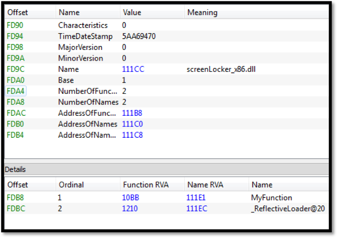

Similarly, to the other TrickBot modules, this module was written in Delphi. This is the first time TrickBot has shown any attempt at “locking” the victims machine.
Image 10: Peering inside screenLocker_x86.dll

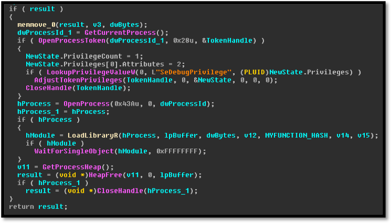

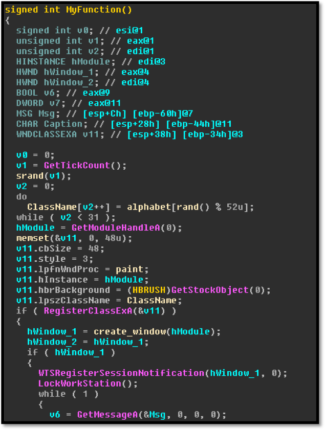

This Module exports two functions, “MyFunction” and a reflective DLL loading function. “MyFunction” appears to be the work in progress:

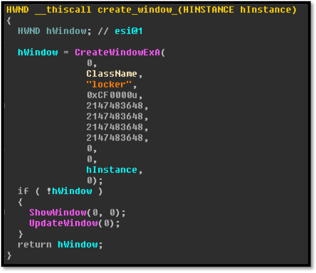

Image 11: Peering inside “MyFunction”
Image 12: Creation of the Locker Window
If the TrickBot developers are attempting to complete this locking functionality, this generates interesting speculation around the group’s business model. Locking a victim’s computer before you are able to steal their banking credentials alerts the victim that they are infected, thus limiting the potential for credit card or bank theft. However, extorting victims to unlock their computer is a much simpler monetization scheme.
